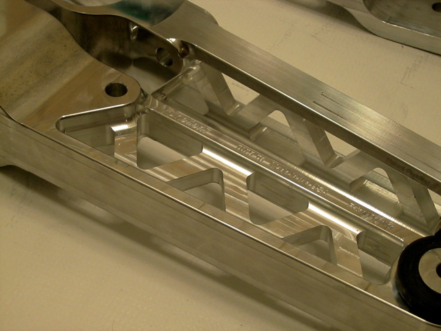

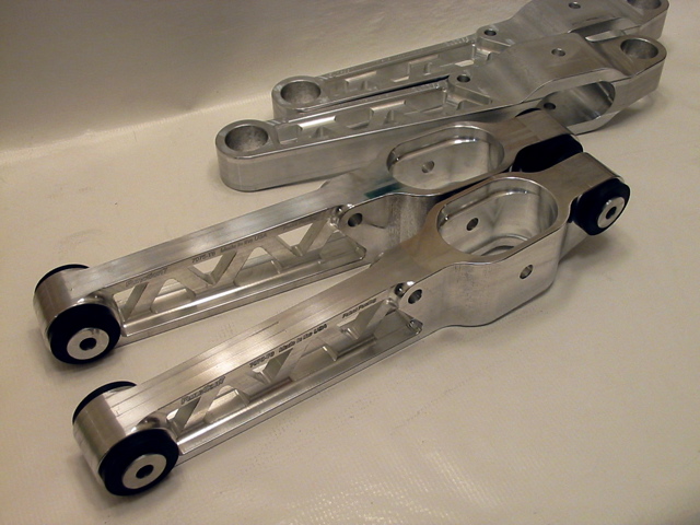

Bon, ma p'tite réflexion fait son chemin ... :wink:
J'pense avoir trouvé mon bonheur ... :P
C'est fabriqué par Function7.
www.function-7.com
This is an auction for one pair of Function7 Ultralight Rear Lower Control Arms. Like all Function7 products, these arms are precision machined out of the strongest, airframe grade 7075 aluminum, and is 18-20% stronger than the "aircraft grade" 6061 aluminum that other manufacturers use.
These arms weigh ONLY 2.5lbs each! Compare that to the heavy stamped steel ones found on JDM Hondas and Acura Type-R's.
This pair of arms will allow you to install JDM or Type-R struts onto your US Civic/CRX.
These computer-designed Function7 lower control arms are patented have been thoroughly tested, first with computer stress analysis, and then on and off the track, on roadrace cources, off-road rallies, and of course the drag strip.
Features
High quality custom-made polyurethane bushings (manufactured to our specifications by Energy Suspension) provide extended life while retaining excellent performance characteristics.
Aluminum CNC bushing inserts prevents rust related issues found on stock bushings.
Modular design allows individual component replacement and makes bushing rebuilds simple.
Entrapment-type bushings do not require set screws which cause undue stress points.
Full width bushing journals for maximum strength & reliability under the most extreme conditions.
Micro-engraving ensures that the product is a genuine Function7 product.
Each arm is individually serialized & bar coded for quality control and trackability.
Sway bar mounting holes are provided for the easy installation of most factory and aftermarket sway bars.
Optional sway bar linkages are available to mount factory and aftermarket sway bars.
Connaissez-vous ce genre de matos ?
